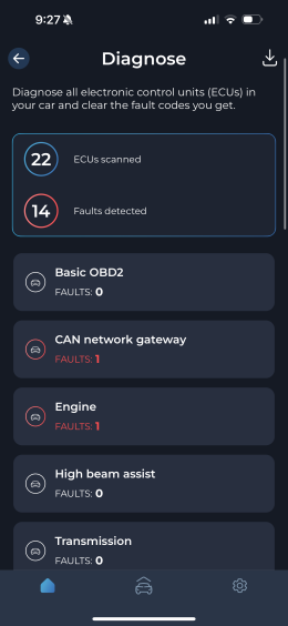

Scanning with Carista obd dongle :
22 ecus scanned
14 returned errors below
Lots of research suggested a possible battery fault. I tried charging battery overnight. No effect, errors returned after clearing.

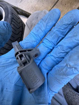

The Faulty part (audi part number WHT003856A, there has since been 'B' and 'C' revisions of this part). Visually it looked fine, but was knackered inside.
The errors in carista prior to fixing:

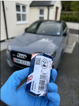

The bosch replacement ( offside rear right with adaptive cruise control support )
All those warnings fixed for £20 of sensor.
22 ecus scanned
- Can network gateway
- Static current: too large
- Engine
- Databus error value received
- ABS
- Tire pressure monitoring system (TPMS): Signal Malfunction
- Electromechanical parking brake control module: Wheel speed sensor implausible signal
- Rear Right ABS wheel speed sensor: Range/Performance
- Power Steering
- Back up Camera
- Steering Column lock
