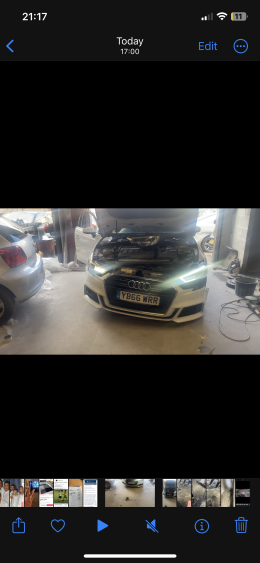

So I was wondering if someone can help me with my headlights.

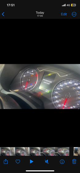

I had the common issue of drl failure and after several weeks of looking everywhere I found a pair of new headlights. Once fitted the drl works fine, indicators and main beam work fine however there is no high beam and it’s coming up with a Audi adaptive light fault.
I did not have this problem on the previous light, I switched the modules over and still the new headlight comes up with the same fault and no high beam at all.
has anyone had this issue before? Is it a simple coding fix or have are the new headlights just faulty? The rear modules and ballasts all have the same part number.
If I'm not mistaken, I think that if the module (7PP941572AC) is not from the same headlight, you need to flash it with ODIS or VCP.
For the Audi adaptive light default, once your module has been flashed and is working normally, you simply need to make a basic adjustment with VCDS.
