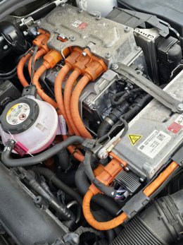

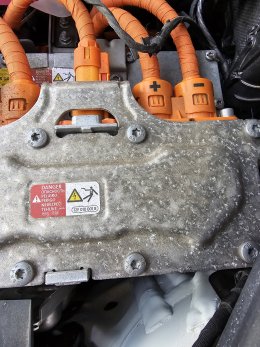

In the meantime I'm attaching photos - I believe the 12v Battery is top left in first pic and second is a closeup but am unsure how to connect Charger's Leads, which are clamp style. Third pic is the box containing my Charger.

I'm pretty sure the 12v battery is not under the bonnet.

So are you saying that the battery shown in the above photos is not a battery then? Before I went away there were 20 miles appx in the High Voltage Battery available and this morning there were about 10 miles. In both instances the 12v battery recovered. In this cold weather I never get more than 28/29 miles capacity. I think you are being very general as my car's manual clearly states that my battery it is under the bonnet - I have checked under the boot floor and can't see anything at all unless it is under the light blue moulded plastic/resin cover. This is securely bolted down though and will be difficult to remove.

No, the unit you mention under the bonnet is the inverter unit, converts the 400v of the HV DC into 3 phase AC amongst other things like regen and definately NOT to be touched. Anything with orange cables is HV and stay away!
