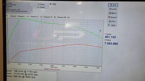

I dyno tested cars with Wagner Intercooler configuration , Eventuri intake , Jb4 module and the performance obtained was disappointing .
Scan 0002
Increase of almost 35 hp but with a poor torque curve.

Comparing performance solely on 0-100 is in my opinion reductive . Can you provide times on 0-200 obtained with Jb4 map 2 ?
Do you have any dyno test charts where you can compare power and torque original car and after modifications ?
The power diagrams I posted on my first setup were with Jb4 map 3 and it was not exciting . I think Jb4 is a very good product but the maps provided were tuned on US versions different from those on the European market . Surely a tuner who knows how to work on Jb4 can get better performance.
My intention was to provide information on what can be achieved without mapping cars while maintaining warranty. With investment of an increased Intercooler costing 1,050 € plus assembly ( in my case zero since I assembled it myself in the garage ) plus chip box with Seletron that intercepts engine RPM / TPS and can be programmed cost 550 € + 300 € dyno tuning by a competent tuner seems to me a good investment for 60 hp and 70 Nm.
