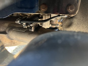

As a follow up to the original post. I solved the issue at the time but it came back again this week in the warmer weather. It’s solved again. I used a can of GT85 which seems to work really well. I’ve attached photos of where to aim the lubricant. The photos aren’t the clearest but I hope you can see what I mean. A kind previous poster on this thread highlighted the pivot point where the issue seems to stem from. You need to get the lubricant in from the top tho.
If you’re looking directly at the sport exhaust, just above that there’s a small opening under the diffuser that you can see into. From there you can see the electronics that open and close the valve. There’s a pin that comes up from the bottom pivot point that a previous commenter circled, up into the electronic switch.
Just below the electronic bit, there’s a metal clip that goes around the upper part of the pivot pin. You want to get plenty of lubricant into there. I hope the photos show what I mean.

That’s looking at drivers side exhaust (uk) then you need to get your hand with the can of lubricant in behind the drivers rear wheel
