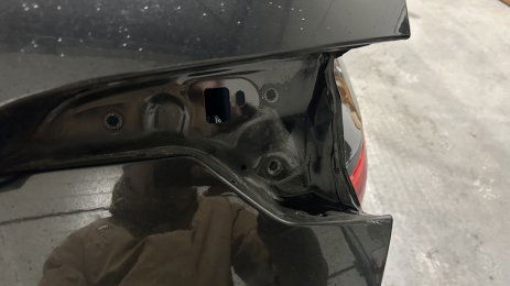

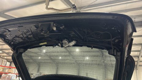

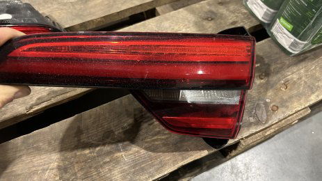

Hello, today after self car wash opened tailgate and noticed the same issue…as it is winter outside, put car in garage, removed taillights and removed tailgate trim so it can dry in warm place, but havent found the reason yet. Right one of taillights is also foggy and it seems that water is only in right side of tailgate, really no one has found the real reason yet?… i will put some pics of how it looks for me

Ya seems similar to what I seeing. Small bit of fog in taillight I don't think is related. The lights are sealed as a unit, separate to the tailgate. I'm thinking it's coming from higher up at 3rd brake light as I've checked lights, reg plate area a lot and can't find. The top trim comes off easily if you pull the arms of it inward it unclips. I'll remove my trim again and focus on that area.
