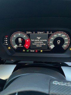

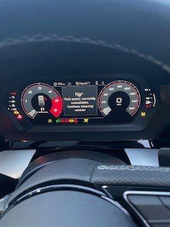

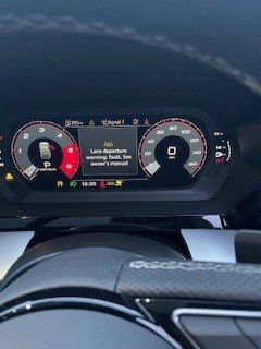

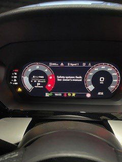

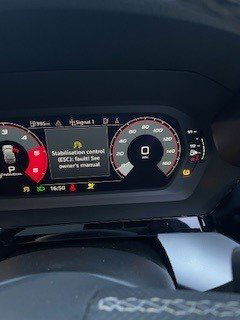

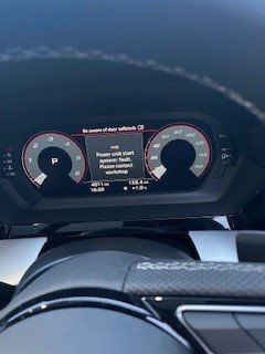

I have a 2023 a3 35tdi black edition and it has broken down twice now with the same issue. Both times it was very cold. All lights on but it came up with lots of beeps and messages and now yet again the air bag light is on and the yellow waning triangle saying take to dealers. Has anyone had this ???

The first time was when my wife was in the car after work. I rang Audi service and they sent the AA out and guess what..... it started straight up. The second time, yesterday, I came to put it in the garage and it just came up with a Christmas tree and loads of faults. Went to get the other key and hey presto it started. Audi had it for a software update but obviously nothing do with that. Both times it has left air bag light on and the warning light. I'm an ex technician and to me it seems like a voltage issue ??

Around zero to -2. Not the handbrake as the car didnt even crank over. The headlights never dipped in power so maybe not a voltage issue ?
Ok then it sounds like a real problem and a need for inspection. Hard to believe it was a battery issue, since it's not that cold yet. Unless it's now giving bad voltage and should be totally dead if there was more cold. Sometimes only half a year old batteries break down in new cars here, where it can be -25 °C like right now.
