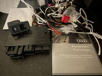

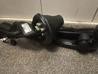

well guys it arrived today a genuine tow bar kit electric swivel/manual even came with the sticker for boot lid and activation pack.
fitted a genuine pull cord type before too my c7 avant but this c8 has every sensor going on it will the rear scanner need too be recalibrated or 360 degree cameras when rear bumper is removed?
anyone looking at part numbers in this kit is for air-suspension model only apparently not sure why curios on the diffrences?

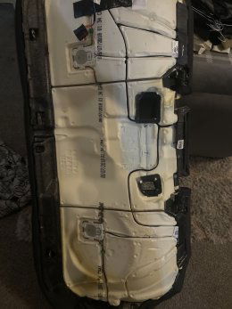

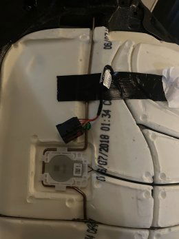

ok installed the towbar today need too code it in correctly thinking of getting main stealers too doo it, rear seat has me stumped any advise id definatly like too take advantage of the rear seat heating thats already installed and wired in?
