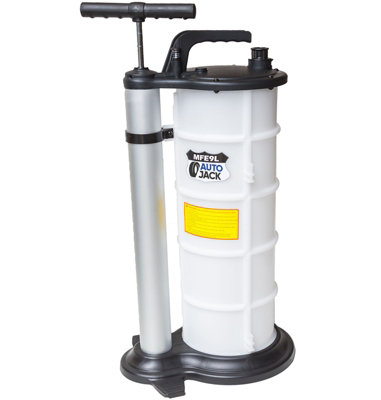

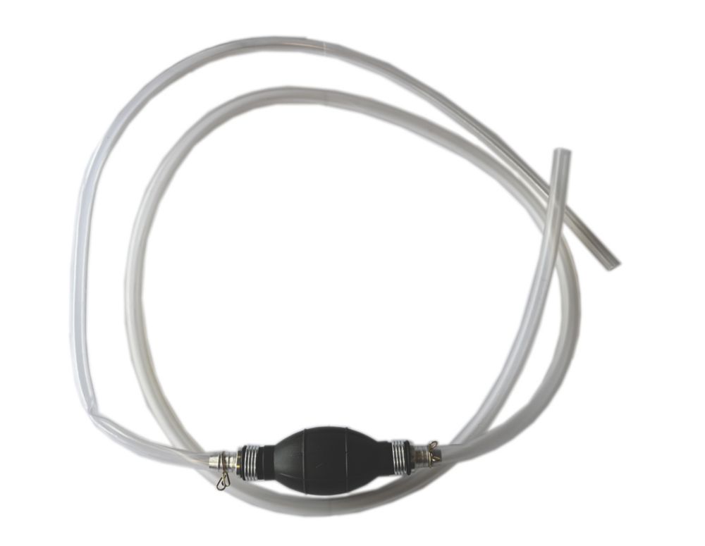

Would any of these devices work or can I drive to local garage

Anyway those Siphon pumps will be no good as the tubes aren’t rigid enough.
You need a proper oil extraction pump. Also best to do it once engine is warm as oil will suck out easier/quicker.
