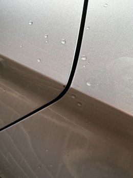

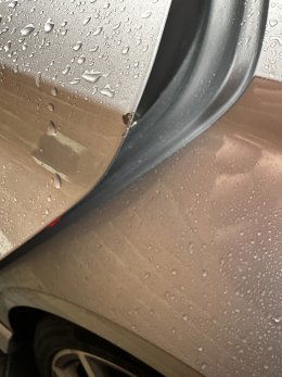

Hi all.
Could anyone offer any advice on a chip I have on the edge of my rear passenger door? I gave my neighbour a lift and she accidentally opened the door against a wall (she’s offered to pay for a repair but it was an accident and she was v upset, crying). I’ve contacted multiple repairers and just get told they either wanna respray the whole door or it’s too small a job for them.
The chip is approx 5mm x 4mm. I’ve bought a Chip Ex kit (I’ve a few stone chips I’ll look at later in the year) I don’t have access to buffers etc.
A few people have said just slowly build up layers of paint….. some have said use a tiny bit of filler.
Thank you all.

Build the layers & when flat, rush down with some 2000 grade with water & fairy liquid, then touch up again, I wouldn't use filler in such a small area.
Yes tbh unless it's a chip company, whole panel is the usual path & problem with chip companies is if they do a blend into the panel areas it may not look the same.

Thank you.
