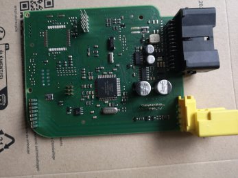

Here is a pic of the circuit board from the module under the steering column, as you can see the pins that would go into the G85 sensor were never there from the factory
Any help would be greatly appreciated
