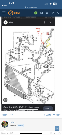

Next I’ve noticed the upper heater hose on the engine isn’t getting hot ( one lower heater matrix pipe is getting hot ). Is there a one way valve or something fitted in the heater pipe?
