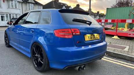

Hi just picked up a set of 18x8 ET45 Wheels and went to test fit them. I'm currently on stance+ coil overs and more or less slammed.
The wheels had some 245/40/18 tyres on them and after test fitting they rub like crazy on what i assume is the rear bumper bolt. about 1mm clearance
Do you think i could get away with putting on my current 225/40/18s from my old wheels?
Read online ill lose around 10mm sidewall and 20mm width. just enough i think to clear the fender liner/ bumper bolt?
Here is some photos of the 245/40/18 18x8 ET45s on.
Any helps appreciated thanks.

18x8et45 with 225/40/18 should work.
I'm running them on mine. Not slammed but lower than oem.
Reactions: D.rc
Went from major rubbing on 235/45/18 to no rubbing on 225/40/18 with oem suspension (et39).
Reactions: D.rc
Can confirm that 225/40/18 PS4 18X8J ET45 ( Stance + coilovers ) fit on the rear aslong as you have around 2.5° of negative camber
