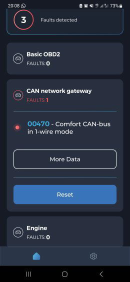

When I scanned the OBD port thete is an error in the can bus that reads "00470 - Comfort CAN-bus in 1-wire mode". From what I have read, I am leaning towards a damaged connection somwhere in the CAN-bus system.

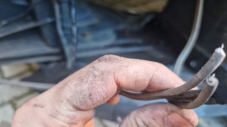

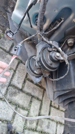

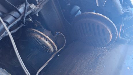

Gave up for a while and then yesterday I was changing my front grill and when I took the bumper off found two pieces which look like alarm sirens I assumed but not sure to be disconnected. Now my initial thought was the person that first had the central locking stopped working maybe cut the connection so that the alarm siren would not go off every time they opened the car. But now on second thought, could this be causing my CAN-bus in 1-wire mode issue?
