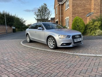

Hi,
Just bought a 2013 a4 s line avant, mechanically sound but exterior needs tidying up as been driven by an older chap for the last few years and looks like he wasnt too concerned with hedges and kerbs.
First thing on the list is to replace the front bumper and nearside front wing.

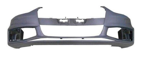

I have found a 2013 bumper on ebay for a decent price, i dont think it is specifically s line, but it does look like the same bumper:
Can anyone confirm if the s line and non s line share the same bumper, and if the avant has the same front bumper? And its straightforward to buy just the bumper and swap in the grilles etc I presume.
I have attatched pics of my s line avant in red.
The sellers car which he bought the bumper for is in silver, its the same bumper as on his car, he bought 2 by mistake.
Thanks for any assistance.

Solved the above, I need S line front bumper with pdc and washer slots, same bumper fits Avant too, 2012-2015 variant 8K0807437S
Now onto sussing out the osf wing. eBay has cheap OSF wings £50 new which look like the right part, 8K0821105J. But they don't mention S line or avant. Are non s line wings the same apart from the s line badge which could be swapped over ? And they the same for Avant too ?
Now onto sussing out the osf wing. eBay has cheap OSF wings £50 new which look like the right part, 8K0821105J. But they don't mention S line or avant. Are non s line wings the same apart from the s line badge which could be swapped over? And they the same for Avant too?
Call Audi parts and get a part code for what’s already on your car. Not sure if you’re referring to cheap wings on EBay, or new wings that are cheap? Personally stick to OE. Lots of posts regards poor fitting pattern parts, plus what’s the point of laying down paint for it to rust. You can treat the inner wing with waxoil or Lanogard if this is likely to be a keeper.
Reactions: olly330
The wings are different between the B8 and the B8.5, ie pre and post facelift. However, I spent months researching and didn't find anything that indicated a difference between Sline and non S line.
As per other posters, I'd recommend finding a crash damaged car and grab the wing from that (and repaint); forget the crappy pattern parts from eBay.
