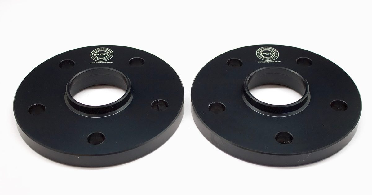

Eibach do 10mm
Mmm ok, I was specifically looking for the rear.
H&R code 2055573A seems to be ok for the rear, as recommendation is:
- Only suitable for cars with a max. wheel hub length of 15 mm
- Only suitable for wheels with an inner bavel of minimum 6x45°
The only 'issue' with that set is, if I recall correctly, that the face of the spacer is slightly smaller than the face of the hub on the S3 8Y if that makes sense. They'd still work though.
