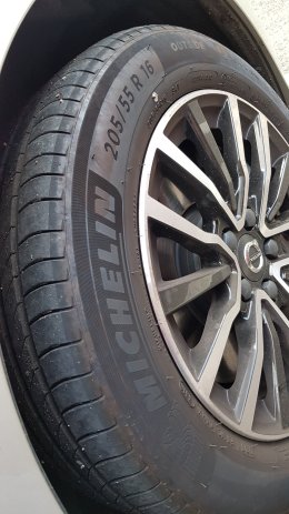

The Pirelli pzero for my 8v is a good example of this. The AO version has a much wider rim protector to the non Ao marked one. Had one fitted at the tyre fitter as they got the wrong one in and it looked like a complete different tyre to the rest of the car which were AO. This at least from a manufacturing perspective is a completely different mould/tooling and possibly a different compound for the rubber used.
I had this very 'quirk' with the Primacy 4 that came from factory on a previous car compared to the ones you can buy to replace. The factory ones did not have the (left circle emblem). I contacted Michelin with pictures (sad I know) to ask why my tyres didn't have them, and they stopped short on stating 'it might not be a legitimate' tyre. They softened their stance once I mentioned it came with the car fresh from the factory in Belgium, and they said, oh, they are OEM tyres, so they are legit.
