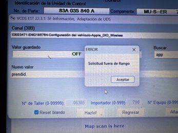

let me tell you, Wireless Carplay is not possible on MS2P because it doesn't come with Wifi 5ghz so, in this case, I was able to config all the channels except the Apple_DIO_Wireless because when I tried to change to ON I got a Request Out of Range message using vcds tool as you can see on the picture.
About Sport Layout, I tried to active many options on the module 17 but nothing found.
For example for module 09, Adaptations are grayed out

Sports layout / display cannot be “coded” with VCDS and alike I am afraid. It’s why I keep telling you to visit someone with the correct tools and knowledge. Not really sure what else to tell you.
