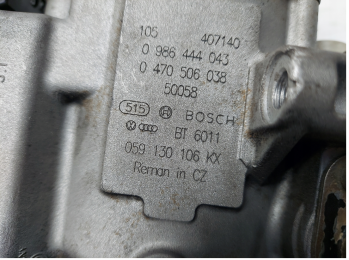

Hey cool thanks. Managed to get the exact same code so all good. But have a issue with timing adjustment. Before I took the old one off put car into TDC, locked old vp44, pulled it off, locked new vp44 and installed, but timing is too advanced. So I want to re calibrate timing with DTI gauge but the number it should be set to is not stamped on the new vp44 neither the old, the old one all the number have been filed off.
Would you have any idea what the DTI should be set to? Or where I could find out what it should be?
I've attached a photo of the ID plate on the new vp44

Sorry I have no clue, the last time I messed with one of these pumps was more than a decade ago.. I suggest you try and find more documentation from Bosh or Audi.
