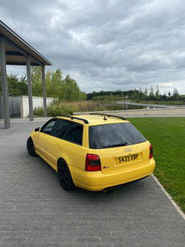

No mate. I took the calipers apart and basically reconditioned them, bought new pads and stuck them on, been as good as new since, here's a photo of it on the morning of the car show
