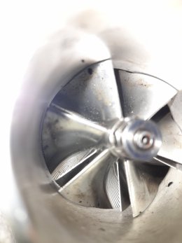

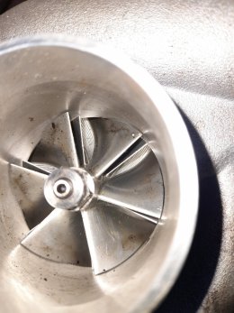

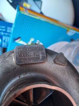

I have been given what is some sort of a K04 turbo for my s3 1.8t but I'm unsure on what brand turbo it is. I know it is not the standard borgwarner turbo. It has turbocharger model: F23 stamped onto it but I can't find any Information on this. Would this just be a cheap Chinese copy? I was planning on getting it refurbished with a billet wheel but if its not an genuine branded turbo I won't bother. If anyone could clear this up for me it would be much appreciated.

I believe it could be an f23 FrankenTurbo !
Check on the internet to compare it?!

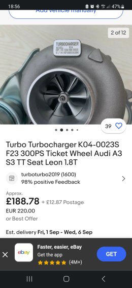

More likely to be the cheap (200 quid) F23 Chinese copy... with the improved compressor wheel...
2nd hand real frankenturbos are still ££££s as they have larger compressor housing, ported hotsides and clipped turbines... these cheap turbos are more like copies of the turbo-rebuilds hybrid CHRAs
