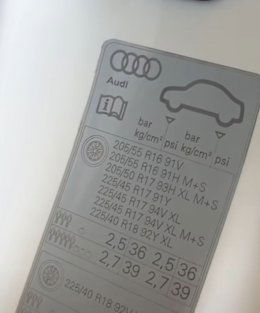

I bought my car almost a year ago and it came with "Nexen N'Fera Sport SU2" tyres. Not a bad tyre to be honest, but it felt a bit numb and too understeery if you know what i mean. I also had kinda low feedback from the road, and driving was not so enjoyable, so i decided to keep them for a bit but eventually change them. Long story short, after 6000km i got a puncture, so i went to replace them with "Goodyear Eagle F1 Assymetric 6".
Current tyre size: 225/45/R17
Rating: 91Y
After replacement was done, i asked the guy who replaced them what pressure he inflated the tyres to and he told me 32 psi.
I told him that the manufacturer's recommended minimum pressure is 36 psi, as shown at door sticker, and asked him to inflate them to that pressure.
To this, he replied that "36 psi is too high", especially for summer in Greece, and that i should use 30-32 psi now and only use 36 psi during December and January when it's cold. I was a bit sceptical to that, but didn't argue at that point and left them at 32 psi.
I don't want to sound like a smart-pants, and i may be wrong, but I'm pretty sure 32 psi is the wrong pressure, no matter what the weather is, as the manufacturer would have taken this into account when recommending 36 psi, or at least have included it as a seperate criteria, just like with the car load.
Any thoughts about this ? Shouldn't i inflated them to the recommended 36 psi (asssuming standard car load) ?

You ask: "Shouldn't i inflated them to the recommended 36 psi (asssuming standard car load) ?"
Answer: Yes, and then monitor wear across the tyre surface i.e., 'too hard' and the tyre will wear more across the centre tread

Correct tyre pressure is the one printed to the car sticker.

Yes, i'll probably stick to the manufacturer's recommended pressure.
