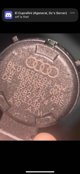

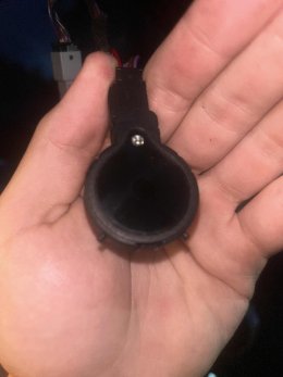

Hi mate done as you suggested, it was all plugged in when unplugging it the windscreen wipers work normally again, but once i plug the sensor in again the faulty wipers return. I had a look at the gel pack it doesn't seem to be damaged? ( attached photo )
Should i just order a replacement sensor ? thanks.
edit: Looking on ebay, I assume as long as its got the same P/N as mine it should fit? seeing a load of a5's seats etc.

Unless you're comfortable with wiring to connect 3 temp wires to confirm it's not this, I'd just get a used sensor, same part number.
