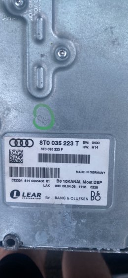

Found an b&o amp the part number is
8TO 035 223AN.
Mine is 8T0035223T
Will it work? Has same amount of connections.
Most likely there will be coding and component protection to deal with first if you looking at second hand bits.
Seems hard to find a definitive list of part revisions that are compatible but looks like your age and MMI spec had revision F and then T being the newer one.

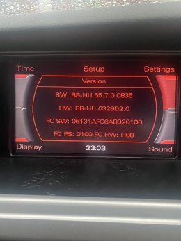

Do you have MMi 2G has more of a red colour screen or higher spec like 3G?

I believe i have 2g , got the controls around the gear stick & cd changer above the controls.

Ok yeah 2G. This page seems to show a list of the parts and revision letters depending on 2G and 3G.
2G
8t0 035 223 T
8t0 035 223 F
8t0 035 223 C
8t0 035 223 M
3G
8t0 035 223 H
8t0 035 223 AN
8t0 034 223 AK
