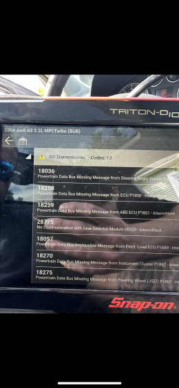

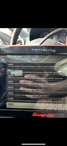

issue: coming to a stop the car will drop rpms and throw an engine, esp, and sometimes abs light, PRNDS will flash with full blocks behind it, and i am unable to get a gear to select whatsoever. Cycle the key on and off and quickly place it into manual 1 and it will take off (but not always right away) occurs almost exactly 230 miles on the dot every time after letting it sit for a day.
Codes scanned by a snapon and returned 12 codes (see images)
Upon scanning the car, the voltage was showing roughly an average of 13.3 volts which to me was low. I went ahead and replaced the alternator with a refurbished Bosch and works great - but didnt erase the issue. Im perplexed and beside myself, no shops that i know of in maine will touch a DSG unless its the stealership.

You need to resolve the power train bus issue, then see what's happening, you could try a gateway module, could be wiring, hopefully they did the mech unit job as per spec.

Thanks, just to note these 12 codes were taken before the new alternator was installed, i have yet to have my friend scan them again
