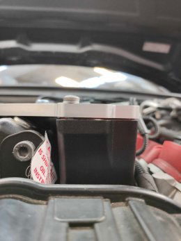

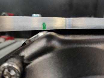

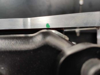

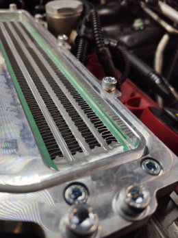

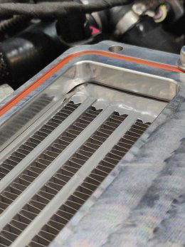

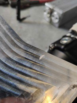

- Supercharger clearance was off, first was that the charge cooler cores were sitting proud so the supercharger plate wouldn't seal, we found one of the end tanks on the core was welded crooked so the o-ring wouldn't sit in properly, required cutting off end plates and re-welding straight, we also had to linish the welds and cores down to fit.

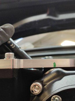

- When the Supercharger was bolted to the plate it was bowing it out as it was fouling on the supercharger itself, we had to clearance the plate to make it fit.

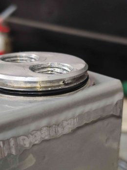

- Charge cooler end tanks. First issue was the o-ring's supplied were too big and were wrong for the end tanks. Second, the CNC end plates on the end of the charge cooler with O-ring bosses were not welded on straight so they didn't fit the supercharger correctly, and third the end plates were incorrectly machined and wrong fittings supplied. The taped holes for AN coolant fittings were machined to close to the edge of the of o-ring boss's resulting in very little material left, causing the O-ring boss to crack and pull away, closer look found the threads cut had broken through the other side. We ended up having to cut off and have new plates with o-ring bosses CNC manufactured with the coolant fitting holes machined closer together and re-welded to remedy.

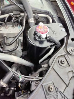

- Water reservoir supplied did not fit at all, was different to one in the installation instructions. Couldn't find anything locally so ended up making one in house to fit

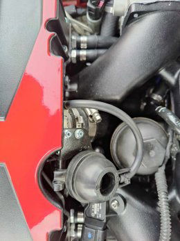

- Supercharger bypass valve failure. Once supercharger had been fitted we finished tuning on dyno, everything was looking good until the next day the car started hunting under idle, we smoked tested the system to look for leaks and found the supercharger bypass valve had failed and was leaking internally on the vacuum side sucking air into the manifold causing the idle to hunt. We fixed this by replacing the valve with the factory actuator for the manifold flap control and fabricating a bracket to make it fit.
