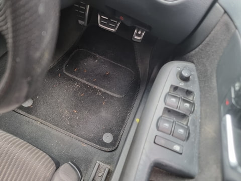

And i decided that i'm going to make my own matching footrest/deadpedal... as the ones i've seen online all put me off because they don't match. the only one that matches is the one for the B9.

Still have to modify the pedals for the S-line version metal pedals. But they are here... just need to get myself in the right state of mind first. And i need to get some super strong 3M doubleside automotive tape to secure the lot after i'm done with the modifications. As i'll never pull them out.

S-line metal pedals & footrest installed ... the pedals put up a fight but i won in the end ( everything needed to be modified) but it i done and you wouldn't even think twice about it if you'd look in my car.
Reactions: Charlie Farley
