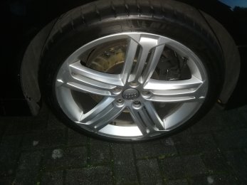

Said wheels

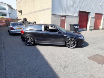

I had GTI wheels, gonna refurb and stick them back on, with 2mm spacer perhaps
