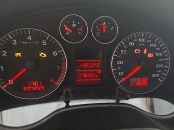

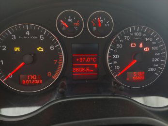

Hi everyone! For almost over a month, my DIS shows wrong numbers, it's like it keeps 'stacking' km & hours numbers. As you can see in photos. It was all working until I put footwell lights, or at least I think so. Scanned with OBD11, just irrelevant simple faults that even after cleared, still the same wrong numbers. Any ideas on this?? Maybe it needs a battery unplug or something? Thank you for all the answers! 1.6 FSI

Press the button underneath the wiper stalk until you get a little 1 in the top right hand corner of the bottom section of the DIS.

Got it to work! Thank you bud!
