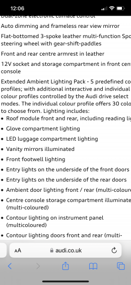

And £44k for an S3 and they are cost cutting with no rear puddle lights? What a joke lol
Just noticed it says on the spec entry lights on underside of rear doors, is that not confirming rear puddle lights then?
We have customers with £60k A4's and A5's come in for glovebox lighting kit retrofit...........
Yes so underside entry lights does mean puddle lights but even though some 8Y customer have had this on their spec sheet their A3's arrived without them.
