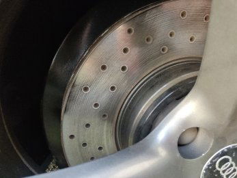

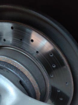

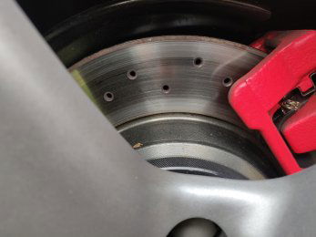

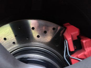

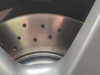

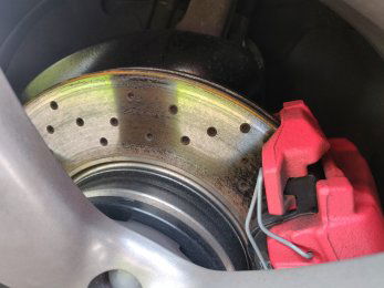

Hello all,
I replaced my brake discs and pads recently and something strange is happening.
I bought Brembo extra drilled (rear) and dimpled (front) discs, and Zimmermann pads for both ends. I did a really thorough job, cleaned and inspected everything, degreased with brake cleaner multiple times before installing, and measured the run-out of the disc when on the hub. I also painted the calipers while everything was taken apart.
The car brakes well and there are no vibrations.
IMG 20230609 144042IMG 20230608 102841
Let me explain everything in chronological order and get to the issue.
I started with the rear brakes. After replacing I took the car for a spin and everything worked fine, nothing unusual.
After doing the front, I had some clicking noise when not applying brakes and some noise when applying brakes.
Upon reading about dimpled/drilled/slotted discs, it appears that it is their characteristic to be somewhat noisy.
The clicking noise when not applying brakes went away after a short time.
Because I test drove the car after doing the rear, it would mean these noises are only coming from the front, but the rear is also drilled so I'm confused?
I did about 200km of gentle driving and did not brake hard to allow the brakes to bed in.
The rear seems to be bedding in fine, pads appear to be depositing some material on the face of the disc, but it doesn't look like it's happening for the fronts, like at all.

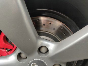

After the car sat for a while and there were some rust spots on the discs, I took it for a spin and the rears were cleared to bare metal when I got back but the front looked like the rust got smeared around instead of clearing off. I know you can't smear rust but that's what it looked like.
Yesterday I took it for a spin again and decided to step on the brakes a bit harder this time. The car was braking well, no vibrations or anything, but it looks like the front discs were once again unphased by the stress they were put under. They aren't even shiny. The rear discs turned slightly brown.
Are the front discs not working well with these pads? Have I been practically braking with mostly the rear all this time? Have I started to overheated the rears?

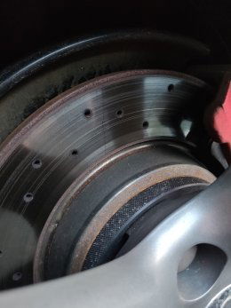

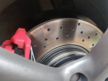

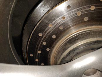

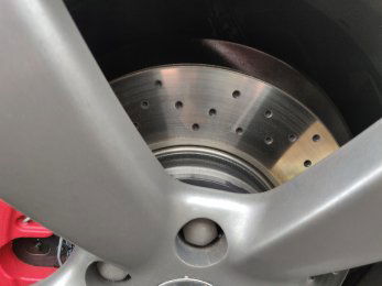

Here are some pictures what it looks like after some harder braking. Rear is slightly discolored and the front are slightly shiny just on the outside edge.
front:
IMG 20230626 085607IMG 20230626 085612
rear:
IMG 20230626 085554

With respect, I usually follow a different (Brembo) procedure, such as follows:
Brembo Brake Bedding-in procedure:
The purpose of this procedure is to gradually increase the temperature in the components without thermal shock and to mate the brake pad and disc friction surfaces, generating a uniform transfer layer.
Procedure Part 1:
• Perform 20 (ish) brake applications slowing from 60mph to 20mph
• Allow 15-20 seconds between each brake application
• Use medium deceleration, approximately 60% of maximum
• DO NOT brake to a stop! (Friction deposits are likely to 'bond' to the brake disc and you will believe you have a warped brake-disc...)
• When completed, drive the vehicle for at least 5 minutes with little or no braking allowing the brake discs and pads to adequately cool
• The system is now ready for normal use
Note: When it can be done legally, or on a closed circuit, a secondary bedding operation is beneficial.
Procedure Part 2: Repeat the above procedure for 5 to 10 brake applications increasing the starting speed to 80mph and increasing the deceleration rate to 80% of maximum. After completion, drive the vehicle for at least 10 minutes with little or no braking in order to adequately cool the components.
IMPORTANT: This entire procedure must be complete before driving the vehicle as normal. It is especially important that this process be completed before any extended same-speed driving is done (i.e. Motorway travel). Failure to follow these instructions greatly increases the likelihood of judder development."
Reactions: 46lukasz and Simon

Hi guys, thanks for the input. Regarding the bedding in procedure, I had a look through the instructions that came in with the discs, they did mention to avoid very heavy breaking immediately after installing, but they were nowhere near as detailed as you posted.
Although I didn't do the hard breaking procedure and braked gently instead, I did pay attention to not come to a complete stop when the brakes are hot, and to allow them to cool down while driving before parking the car. I guess I will keep driving and hope for the best, nothing else I can do at this stage.
The fact that the front discs are starting to have some pad material deposited on the outer edge, looks like it could still be fine.
Regarding the sounds, this video is the best I could find to demonstrate the clicking sound I had for the first few km of driving, when not braking at all.
That sound is gone now thankfully.
This video is similar to the sound I have during braking, although mine is not that bad. I can't hear it unless I am braking next to a wall with the window open.
Hopefully this will go away over time as well.

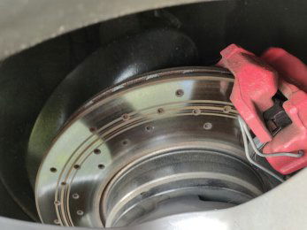

It is not uncommon to go through the hard bedding process again to clear uneven pad deposits so even after doing the gentle process the hard way is still an option.
So i followed your advice and did the hard bedding process again to see what will happen. I found a short stretch of road with roundabouts at each end and just did a couple laps like that, breaking when approaching the roundabouts
There was something starting to happen on the surfaces of the front rotors, although its clear that one side is doing something else than the other (these pictures were taken the morning after)
IMG 20230629 191504IMG 20230629 191518
So i went to do it again
Fronts looked a lot better i think there is some visible transfer layer forming, and the rears got darker in the middle, not sure what's that about
IMG 20230629 210246IMG 20230629 210403IMG 20230629 210256IMG 20230629 210355
after another round they look like this:
IMG 20230630 183848IMG 20230630 183925IMG 20230630 183900IMG 20230630 183910
At this point i think i am happy. The brakes are performing better, with a significant improvement in the initial bite.
I still think i should have went with same brand pads and discs, under the assumption that they are designed to work together, I think that this combination of disc and pads just doesnt work together that well, but it will do for now.
Reactions: 45bvtc

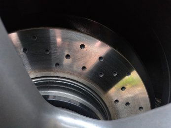

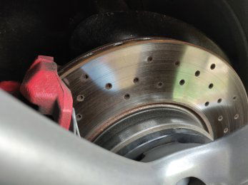

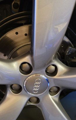

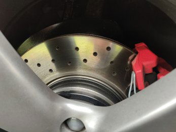

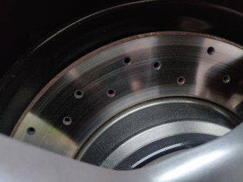

Frankly I am not sure what to expect to see to call it a fully created transfer layer. I searched online and saw a few example pics.
according to the first pic, bedded discs are more shiny with a blueish tint.
according to the second pic, the discolouration i have on the rears is normal.
according to the third pic, a blue colour shows brakes well bedded in, but looks like overheated to me (they are performance brakes on the pic so different rules could apply)
The 4th pic is of my other car, where brembo discs and pads are used. Although a bit worn at this stage, you can see almost a gritty surface, where I assume metalic pieces of pad are embedded in the disc. I would consider them well bedded in, they work great.
I look forward to your comments
Bed unbed carbotechImage 425Intima Bed in RotorsIMG 20230701 112517
I would be less concerned with how they look than how they feel, and if they feel good then I’d call it a win.
Yeah, i can't complain about performance now, but i hope to learn something out of it
I already learned a bit from the bedding in process, but i think it created more questions than answers :D

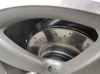

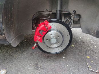

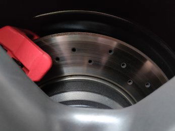

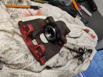

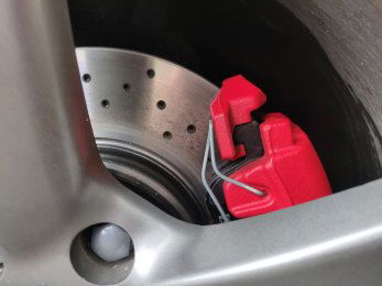

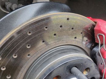

after i thought its going to be fine, the saga continues...
the car was sitting for about 2 weeks, sometimes it rained, discs developed some surface rust, then after quite a long drive the right disc is fine, the left one looks like the surface rust was just smeared across it.
on every other car i dealt with, the discs were cleared and shiny after the first few brakings,
the car still brakes well but i cant help but wonder.
IMG 20230803 190609 IMG 20230803 190557

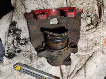

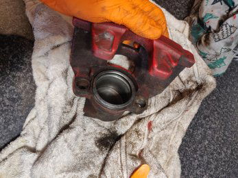

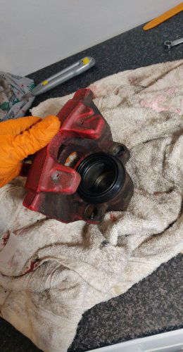

it crossed my mind that the caliper is at fault but I'm positive that its working OK
everything was cleaned and lubricated when I was putting these brakes on, as i took a lot of care at every step
I pulled back the dust cover slightly to check the piston, and there was absolutely no corrosion under it, piston was in great shape.
when jacked up, the wheel rotates freely so caliper is not sticking, and then stops rotating when brake is pressed.
the discs also heat up evenly as i checked this after a spirited drive.
the only thing that comes to mind is that these pads really don't go well with these discs, but i would expect any pad to clear any disc simply due to friction.

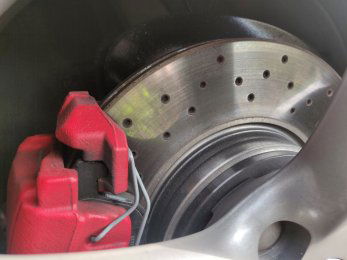

since last post i took it for another drive with some hard braking to clear it again, and the disc is mostly clean except one area, it's bizarre
IMG 20230805 161609
are the discs directional? perhaps swap from one side to th eother and see if it clears up , could be an issue with the disc material itself - would be super odd but potentially possible.

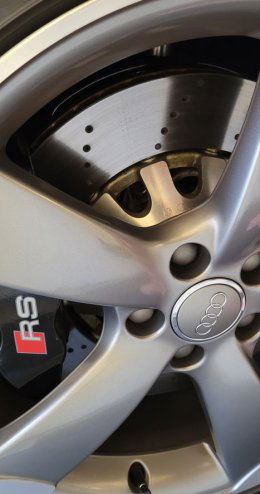

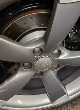

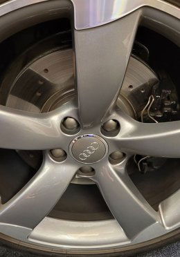

Here's our 2010 TT after 100 miles (Welshpool - Llanfair) on Thursday:
TT fronts TT rears
And our 2011 RS3 after 100 miles (Rudyard Lake) yesterday:
RS3 fronts RS3 rears
Note the lack of brake dust...
Hope this helps

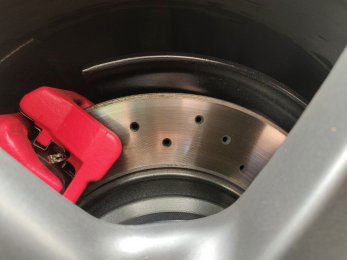

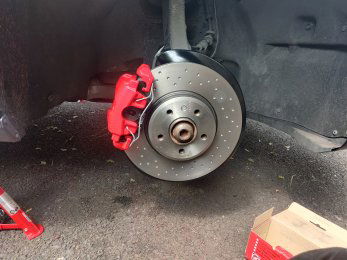

I gave in and replaced the front pads with Ferodo Eco-Friction FDB4045 about 1000km ago.
I can say right away that the initial bite and brake modulation is better with them. And they also clear all the surface rust off the rotor right away.
Even though Zimmermann pads work OK on the rear, I will stay away from them in the future.
Before:
IMG 20231111 113254
After Right Side:
IMG 20231126 151027
After Left Side:
IMG 20231126 151119

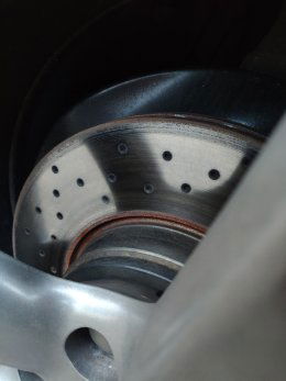

As you can see I now have a few rings on the right side that haven't really cleared. Not sure what that is about.
Initially I thought its a grove left by the old pads, but when I run my finger nail across it, its level with the disc, not lower or higher than the disc surface.
I hope it will clear as well, because its looks botched.

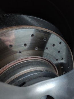

in desperation i got some 800 grit sand paper and cleaned off the face of the rotor. After a quick drive here is how it looks.
visible lines are still there, where the pad doesn't contact the rotor, which would mean there is a low spot on the pad - possibly caused by the surface rust or whatever it was left on by the previous set of pads.
IMG 20231126 155011 IMG 20231126 162321
I guess i could take the pad out and sand it flat again?
View attachment 272380 View attachment 272379
lucky me...
How many miles have you done 'braking!'
Be patient, stop 'flatting' them discs and/or pads, it'll ALL clean up once the 'pad' is bedded to the disc-surface
Question: have you actually done this?

So after driving for 4k km since replacing the front pads with Ferodo set, here is what they look like. They have bedded in enough that the rings on the left wheel are gone.
IMG 20240210 165917IMG 20240210 165855
Things are looking a lot better but both sides are still bedding in, as the outer edges where the pad should touch the disc are still rusting and only silver dots are showing.
I mostly do motorway driving so bedding in slow
Now looking at the rears, I'd say they would also benefit from Ferodo pads
IMG 20240210 165910IMG 20240210 165902
I guess the short message is stay away from Zimmerman pads everyone
Reactions: 45bvtc

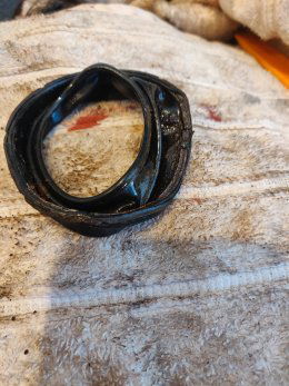

Hello, don't mean to revive an old thread but i have updates, after a year and a half, and around 30k km later, the issue is solved once and for all and I know what the cause of it was.
On the way to a new years eve party the car didn't feel right, there was some shaking during braking and fuel consumption on the dash was through the roof. I managed to get it back home jacked it up and the front passenger side wheel was very hard to rotate by hand, especially compared to the other side. The diagnosis was front passenger side caliper seized.
I started googling and came across this video which as it turned out explains exactly what happened in my case:
Audi 5 Front brakes binding. How VW Audi brake calipers seize
TLDR: the dust boot on this style of caliper for 314mm discs is pressed onto an outside flange of the caliper, it has a metal ring embedded into the rubber to hold its shape, which corrodes away and leaves pieces of crud behind. From the outside everything looks fine but under the dust boot its really bad. These pieces of crud get between the piston and the caliper bore, taking up the clearances between piston and bore, and looks to me like they seize the piston after it heats up and expands after the first few brakings.
The corrosion may have started a long time ago, but as the previous set of pads was wearing out, the piston was only extending out. So this seems to only be an issue after replacing pads, as the piston needs to be pushed back in (together with the dirt now around it).
This is a design flaw in my opinion. Other calipers have a second grove inside the bore, before the main piston seal, and the dust boot has an external lip that goes into that grove, then it's held in place by the piston itself - no metal rings to corrode (like it is done on the rear calipers on this car, and on audi calipers for 320mm discs for example).
I took it apart, cleaned it all out, and installed a repair kit Frenkit 257911 which included a new dust boot, main seal, and a new piston. If you are doing it, make sure to clean up the inside of the bore before the seal, otherwise the new piston may not go in. I then did the other side as a preventative measure, and it was just as bad, just not seized yet but, it was a matter of time.
Needless to say, the car brakes better than ever before :D
Here are some pictures:
IMG 20250129 154744 IMG 20250129 114956 IMG 20250129 121403D6d99aec 5aee 4384 86a9 f8e9de691f93photo IMG 20250129 132734
