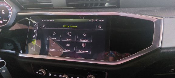

How can i be sure that i dont have smartphone interface please ? because I can connect my phone with Bluetooth and access to call & messages....
Select smartphone interface from your menu. If it says connect a device you have it, if it says visit dealer to activate etc etc then you don’t. If you have an android device and the MMI displays connect your vehicle make sure you have a compatible cable as android is way more fussy then apple CarPlay.
being able to connect your devise to BT, seeing your call logs and messages does not mean you have smartphone interface, it means you have Bluetooth as this is standard behaviour.

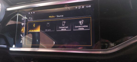

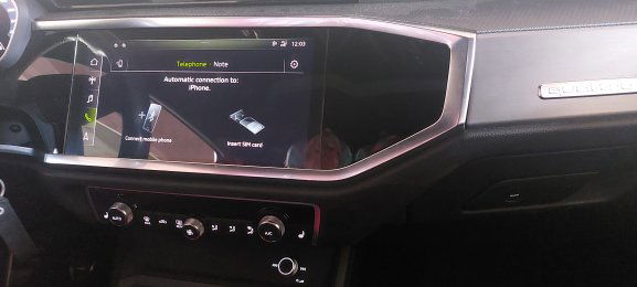

I dont have any Smartphone interface in my Menu, my only concern is to activate wireless Android carplay in my q3 because my USB is Charge Only. is it possible to activate it with VCDS please ?

You don't seem to understand that Android Auto (and Apple CarPlay) are part of what Audi calls "Audi Smartphone Interface", which your vehicle seems to not have. You cannot activate this via VCDS or any other coding tool as what's needed is more involved. You need to speak with a local Audi dealership or VW Group specialist.

you need the smartphone interface activated by vag and most likely the usb port replaced so that it supports aa/CarPlay.
once that’s done the car link kit will give you wireless aa through that new usb port.
