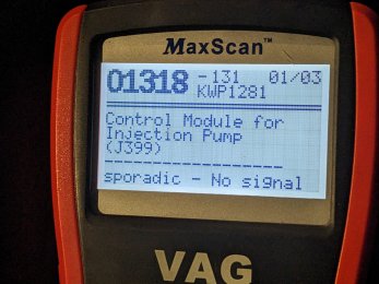

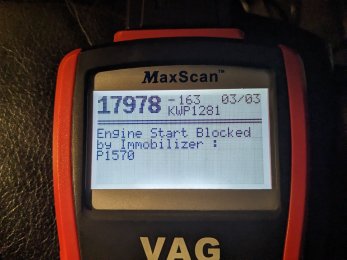

Update, used the scanner and this is what I got, fuel pump it is then, that fix I paid for obviously did nothing.

Clear immo, see if it comes back.
If it's immo it will start then turn of after 3 seconds or so.
