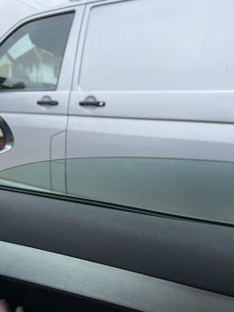

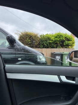

Hi guys I’ve just retrofitted electric folding mirrors to my car and am yet to code them in but having put the new door modules in my front windows aren’t going down all the way and resetting them via the key in door doesn’t help any suggestions would be appropriate

Having played about I realised I routed the cables wrong in the car door so every time the window goes down it hits the cable, just a heads up so other people don’t do it when doing it make sure the cable goes down the side closet to the car and route your cables carefully as I now need to do a bit of soldering
