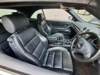

Had a couple of journeys now and noticed some things - it's 18 years old so I know not everything will work and some just might be normal traits !!
It's a 2005 1.8T Sport Quattro Cab.
Not sure what the Sport signifies but it seems quite well equipped - enough for my needs. Has fully electric leather heated adjustable seats with lumber support, dual climate control. Coming from a TT roadster it has the extra space I need but can obviously notice the difference in weight.
The gear change is a little notchy but I'm going to get all the oils changed so we'll see if that makes any difference.
The three central air vents don't seem to do much at all, wherever you divert the airflow to. I noticed in a scan I did it mentions intermittent faults with ' Defrost Flap Motor' - 'Central Flap Motor' - 'Left Temp Flap Position Motor' - does this mean there's a different motor to change where all the ventilation airflow goes ?! I guess if one or two are gone are they a nightmare to get to ?! They were historic codes that haven't reappeared yet but something doesn't seem right.
The clutch bite position seems high ? Or higher than my TT that has just gone. I assume it a hydraulic clutch so it adjusts itself ? So the position doesn't/can't change ?
Radio did work on my long trip down but now doesn't - already been told that the Aeriel is in the boot and the wiring can get damaged over time so got to work out how to tackle that.
It's better on fuel that my TT but then I only had a 5 speed box so it did over 3000rpm at 70, this does about 2,300rpm in 6th at 70 so pleased with that. Doubt it's better around town pulling the extra weight but my journeys are normally mid to longer journeys rather than around town.
Thanks for people's help so far - always great to find a friendly , helpful forum
Pics because I can -
