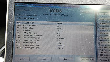

Does this look like a healthy battery? This is with the engine idling. I did try a new bosch agm battery temporarily and it didn't seem to clear my issues so I put the old battery back in. But now I'm wondering if it could still be the original varta agm battery thats faulty. On start voltage does dip down to 12.1v.

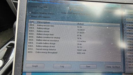

So I just been out in car again. Drove about 2 miles. Thought I'd check battery again after a drive and it showed the below on idle. And then upto 14v this time when idling. However I did notice the voltage drop to 10.8v when starting engine. I'm sure I read it shouldn't drop below 12v when starting? Thoughts...I'd it worth me trying a new battery again and coding.
