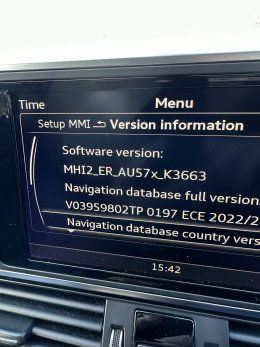

Not getting very far at present mate. I am fairly sure my car will use the newer system where it’s just the camera and cabling (no need for the control module in the boot), and Andy at Audi Upgrades Ltd has said because my car has the High Navigation system, that this is the kit to use. Other suppliers though have said my car needs the kit with the control module. That’s after supplying my VIN number. It’s all a bit head scratchy. I may have a genuine reverse camera kit for sale. Watch this space
If you got the kit with the module why don’t you plug it in and code it to see if it works?
The c7.5 uses the mib2 system like the a3 8v and as far as I’m aware both kits should work. Newer kits just has the module built in the camera where as old kit has a separate box.
