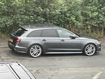

ended up doing this the other day, only dropped it 15mm but very easy to do and I could go abit more but im happy with how it is as it does drop a tad more ive noticed when the wife drives off in it.
fitted some staggered spacers too and car definitely looks more sporty than standard.
