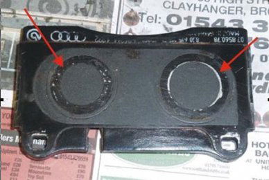

Please check that the pistons haven't worn through the antisqueal material on the back of the pad, like here with the Audi 8P RS3/Brembo/Pagid OEM pads:
Brake pad anti squeal coating wear arrows
Note the 'silver' worn-through the anti-squeal coating rings (after 1500 miles) - brake squeal being high-speed vibration between piston and brake-pad mounting - hense the use of anti-squeal shims.
An easy fix is to apply some self-adhesive (3M/Mintex) anti-squeal shims, like so:
UntitledMA29988801 0003 10x PAD2
And after 5000-miles, self-adhesive anti-squeal shims still working well and zero wear-through:
OSF pads at 5000 miles
Hope this helps...
