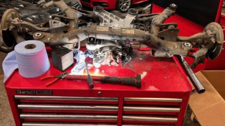

Hello, for anyone who finds themselves in a similar situation, it was the rear diff.
