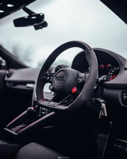

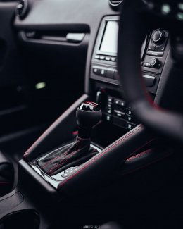

Hi all,
I Was scrolling through AutoTrader & came across this modded out RS3 with white LED buttons.
(https://www.autotrader.co.uk/car-de...s=1500&page=1&percentVehiclePriceDeposit=true)
I really want to do this to my A3 8P1 after I've recently upgraded the dual climate zone control to the unit from an Audi Q3 that has a white display. I'm handy with a soldering iron & have the confidence to try this mod out for myself. But I have no clue what type of SMD LEDs would be compatible to swap the old LEDs out with.
Has anyone attempted this mod themselves before or does anyone know what LEDs I should purchase?
