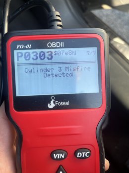

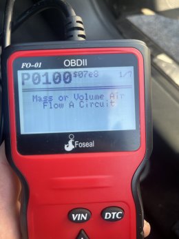

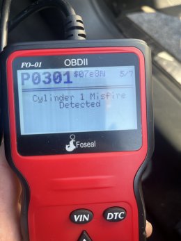

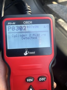

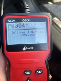

So I’ve just taken it out for a drive. Idles perfect again. Under throttle it’s horrible. I’ve got a video of what it’s like to drive. The engine light comes on towards the end. Also just got the code reader and I’ve got ALL cylinders misfiring
Anyone got any ideas on what causing all cylinders to misfire.
