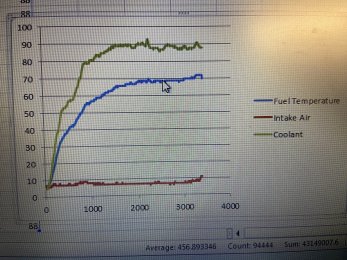

2. Fuel temp only gets to 76C if I boot it and drops back to 70C but the coolant gets to 90C. Is this normal for a fuel temp sensor? Drove the car for 20mins then stopped as I couldn't get the fuel temp higher, outside air temp that day was 10C. My assumption is the fuel temp should be close to the coolant temp but may be wrong for BMN? Note the coolant temp goes to 94 if I boot it but drops back to 90-92 during normal driving.

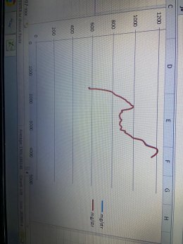

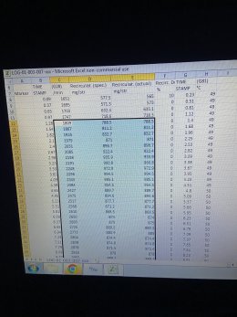

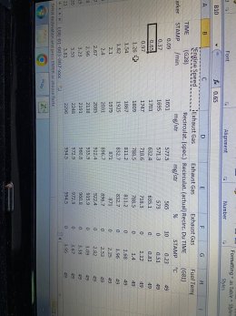

3. MAF/EGR actual and specified logs are doing something weird, logged all gears up to 4k revs (warm engine), and all of the logs actual and specified match exactly for each time stamp. This is not normal I presume? Surely the specified and actual should not match EXACTLY? why is the ECU not throwing a MAF error? I cant think of any reason the actual would match the specified exactly. Or does the ECU overwrite actual during MAF failure? I would love to know the answer to this. I have added pictures of the MAF/EGR logs in 3rd gear up to 4k revs. Note the graph shows both specified and actual but only see one line as they are exactly the same. You will notice that at low revs and idle the actual and specified are slightly different, at idle they jump around at 450ish. As soon as the load increases they match.

Just attached log from cold, to show that at idle the specified and actual are the same till 1800 revs,
will log the fuel temp first thing with no engine running to see if fuel and coolant are same as air temp.

Just logged from cold a 45min drive?
fuel temp sensor fault? Its starts correct (outside temp)

I just tried to test the EGR in the output test with EGR off the car (plugged in) but there is no option to test it. Why do I not have this option? So instead I ran basic settings test, and the car revved to 3000k then back down to 1400, then the egr value went up and down more the 100mg/st which I assume means the EGR is working. The duty cycle went to 40% then back to 0%, stating 0% is closed. However, when I drive the car in all gears at all revs ranges the egr stays at 0%?
I am really stuck with what this car is doing. To add the Lamba/o2 sensor starts in range, as it warms up it goes above range, as in above 1.0-2.0 and sits at 5-6.
