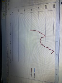

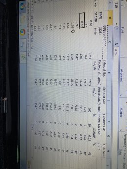

for some reason egr specified and egr actual are exactly the same when I log through the gears up to 4k revs (engine warm). Starting at 450ish to 1050 during load. Has the MAF failed? Why would it not throw a code? I thought it defaulted to 500ish? Or is something else going on?

See attached images? They are slightly different then match? How is this possible? Either the actual is set by ecu default or ecu speced is showing actual?
seems at low revs is slightly different. Then as revs climb they match exactly. This cant be normal?
