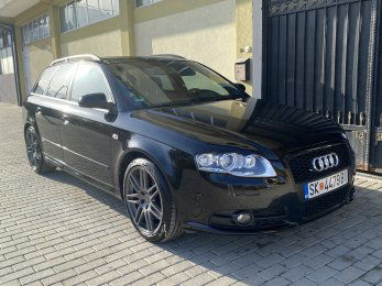

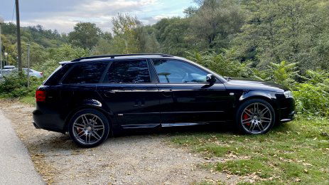

Post up some pics of your car. Looks wicked from the avatar!
I was tempted to buy another B7 in Black recently. B7 look so good in black
Reactions: Fatihh_b7
Indeed it does! The compliments I get are: It scares me! Haha
Even though I haven’t had it detailed, the Brilliant black color makes it look deep, and being a special edition, the black accents complement it.
Yeah! I agree with you, I also have a B7 in reflex silver, which i own for more than four years, but the moment my eyes fell on this evil one, I couldn’t get my head off of her, so i traded my VW Golf GT for her.
I haven’t taken the time to photoshoot her better but anyway..

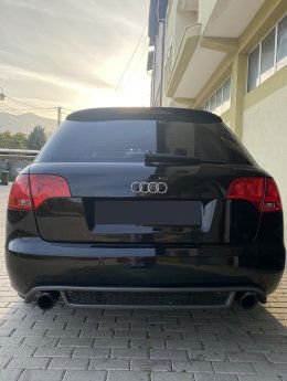

Any rear pics, not sure what this bit is, looks a bit bulky for ex tips but maybe the angle of pic.
1673102697895
blades look like S4 items, but again maybe the angle of pic.
1673102837009
Not much gets past my B7 radar..:yes:
They do look good.
RDX diffuser color matched to the wheels, and Akrapovic 89mm carbon gloss tips.
