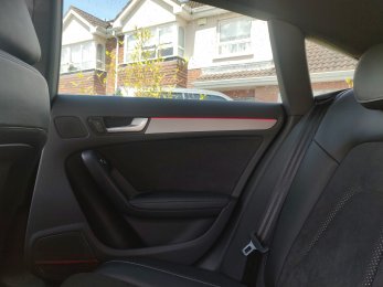

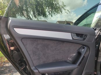

Pictures say a thousand words so what I would like is ambient light in the places marked in red:
Vehicle Automotive design Motor vehicle Personal luxury car Vehicle door
I would like to make it very subtle, so not very thick, just a small thin stripe of light.
And my goal is to make it look like it came from factory like that. I think that otherwise it would look like a hack/cheap.

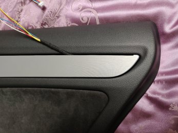

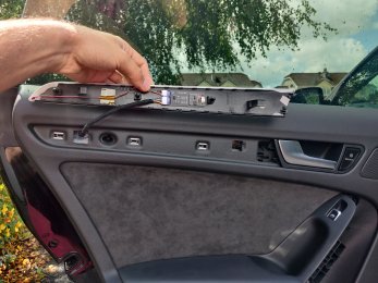

My own door trim has the brushed aluminium finish, but I am not willing to risk cutting it up so I bought a cheap second-hand door trim set out of an A4 (A5 and A5 share these parts). The set I bought is a basic trim level set - just plastic and no aluminium or other inserts in it, so that its easier to route the grove in it. The plan is to wrap it in brushed aluminium vinyl later on, to get the original look.
The A4 also has an additional trim piece on the passenger side, above the glove box, so I will use that as my next test piece.
Dishware Wood Rectangle Publication Tableware
I got my inspiration from this link, although it is in Spanish and the man used the larger LED strip which was a more invasive method, and I think he needed to cut up the door card from the inside to get it to fit.
Reactions: NHN

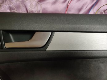

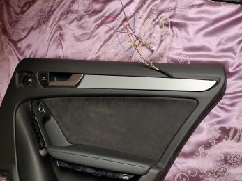

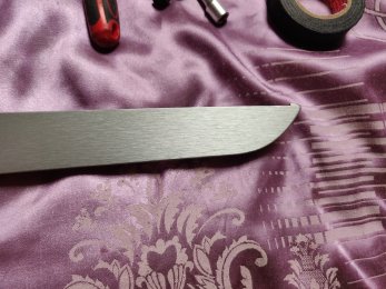

So using the routing table I made, I went ahead and cut a slot on top of the passenger side A4 trim piece that I decided to sacrifice as a test piece.
I did a few passes until I got the right depth as I kept test fitting the LED strip. I then sanded the trim surface slightly and degreased it before wrapping.

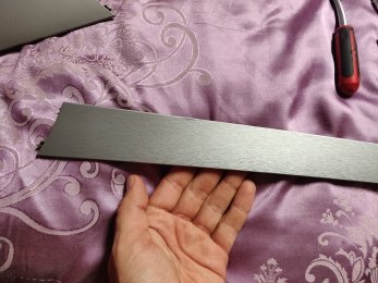

The wrapping vinyl I got turned out not to be the best quality, as for example it is not perforated so some trapped air bubbles occurred.
I also managed to get some pieces of dust stuck between the trim and the wrap so they are visible in the bottom left corner. But its just a test piece so it will have to suffice.
I am not a wrapping pro, but apart from the issues above I think it turned out acceptable, and looks quite close to actual brushed aluminium.
I think if you didn't put the wrapped and real thing side by side, you wouldn't be able to tell. I have my centre console wrapped already and it went well with the stock door trims with real brushed aluminium.
I then glued the LED strip in place and the results are below. Personally I really like it.
The only negative I can see is that the profile of the LED strip does not match the curve of the top edge of the trim, so the corners stick out 1mm or so.
But I think the door trim pieces top edges have a sharper corner rather than a radius like this one, so it should be less visible and not stick out as much.
There is a piece of the LED strip wrapped around the back of the panel, that obviously will not be there, I just did it like that for the test and to power it in the easiest way possible.

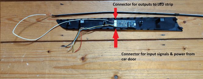

Hello,
I ordered more aluminium look wrapping vinyl with air release pinholes so hopefully that's better quality.
I have to wait for it to arrive so I moved onto the electronics side of things.
I used an Arduino microcontroller to drive the animated LED strip from the video above, but I chose to use the ATtiny85 for the real deal. It's very small and can be glued with double sided tape to the underside of the door trims.
IMG 20230126 181229
The arduino is a much more capable MCU compared to it, but in this project it does all I need it to do (not a lot to be honest) and the small size is a plus.
It also has an on-board voltage regulator so it can be powered by the cars 12v system even though it's made to run at 5v.
Like I said in the first post, the plan is to power it with the same supply that powers the internal door handle illumination. This means it will power ON when unlocking the car, and still stay ON for a few seconds after locking the car.
The only issue with that might be that the door handle light supply might be pulse width modulated to control brightness. I'm not yet sure if the ATtiny can be powered with a PWM signal, even at higher duty cycle. I'll have to check that out first.
Next is the issue of sensing when the door is open/closed or when to turn on day/night mode.
Door open = puddle light ON
Night mode = buttons illumination ON
I can tap into these wires and use them as inputs to the microcontroller to determine what to animate on the LED strip. However these are 12v and I need 5v input signals, otherwise the ATtiny will break.

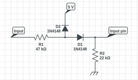

The solution is to use a voltage divider circuit. Since it's a car and we care about safety, we should use an automotive style voltage divider that has clamping diodes as a protection during higher voltage.
At 12 V, the circuit will deliver 3.6 V to the Arduino pin which is a clean HIGH input signal. This circuit is principally for automotive use where the voltage input may routinely be as high as 14 or even 15 V.
Schematic A
The safety feature here works like this, when the voltage is so high that after R1 it is more than 5.7v, D1 starts conducting (most diodes need 0.7v to turn on) and lowers the potential at that node, making it safe again.
From my testing, when Vin was 15V, the voltage at the anode of D2 was 5.12V, so still not enough to turn it on, so this protection kicks in at even higher voltages, e.g. voltage spikes.

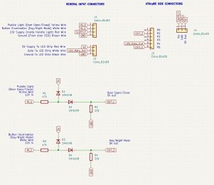

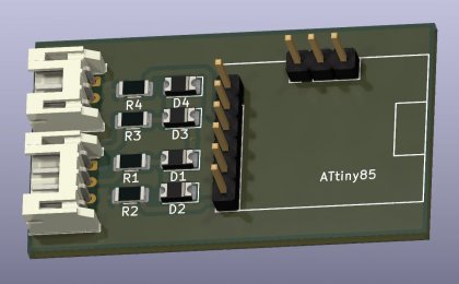

I designed a PCB that has two of these automotive voltage dividers on it. The ATtiny will sit on top of it, and it will also have 2 connectors, one with 4 pins for connecting to the car (power, gnd and the 2 inputs) and a 3 pin connector to connect the led strip (5v data and gnd)
To manufacture 5 of them costs 3USD on JLCPCB so it's not expensive, but I will get it ordered when I confirm that the ATtiny can work with the cars supply.
If it turns out that the supply is PWM and can't power the ATtiny, I will look into it and probably add stuff to it to make it work.
The PCB is 45mm x 25mm in size, and most of it is empty space for the ATtiny. It's only 8 components after all.
Schematic1 Pcb design Pcb render

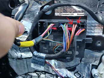

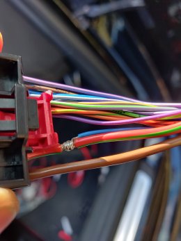

Hello,

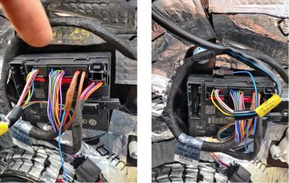

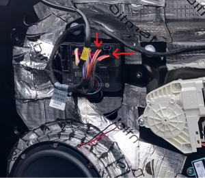

Last weekend I managed to take the door card off and tap into the signals that I am interested in, and route cables to do some testing.
I prepared the circuit and the microcontroller on a breadboard before i order the PCB and tried testing it out.
I confirmed that the voltage dividers are dropping the voltage to a usable level, so the microcontroller will be able to tell when the door is open/closed or will know if its night mode when the switch backlight is on.
Unfortunately it appears that the door module is limiting current for the inside door handle (I planned to use this to power everything), because as soon as I connect the circuit, the handle light switches off and there is a fault when the car is scanned. The light comes back next time you unlock the car.
It works when powered via the puddle light - of course that only works when the door is open.
So the plan now is to use a relay of some sort, to get power from somewhere else (the door control module must get a constant 12v somewhere) but still use the inside handle light to trigger the relay.
Another issue is that the inside door handle light is powered with at PWM signal. So it still needs to be smoothed out, otherwise it will cycle the relay really quickly.
Maybe a low pass filter circuit or putting a decoupling capacitor between that signal and ground will work. Thats some more experimenting i need to do.

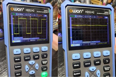

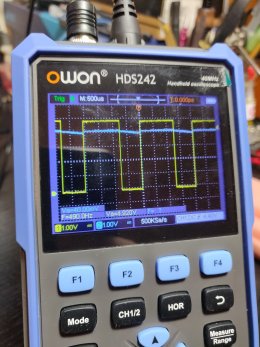

Simulations are one thing and real life is another, but they are close. In my testing I used an Arduino board to generate the test PWM signal, however the Arduino is capable of generating PWM of 5V at 490Hz, so a bit different than the 9.3V at 156Hz coming from the car (I was expecting 12V but saw 9.3V on my oscilloscope shown in the last post, so I'm going with it and not questioning it), meaning the real capacitor value will need to be selected while testing on the car itself.
The picture below shows the original input PWM signal in yellow and the smoothed output signal in blue. Output voltage is a bit lower as the voltage drop across the diode is 0.7V
With diode
The voltage of the output signal doesn't matter (as long as it's not too low), but an appropriate resistor needs to be selected to drive the relay input at around 5-25mA of current.

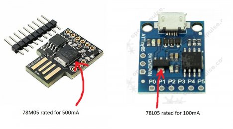

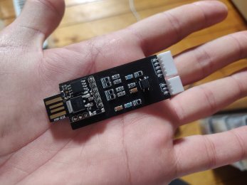

I noticed that the voltage regulator on the attiny85 that I have gets warm when powered with 12V, I looked it up and saw that it is a 78L05 and it's rated for only 100mA.
I ordered a different version of the attiny85 board with a 78M05 regulator rated for 500mA instead. Again that will be a safe margin, as you can see from the picture the regulator is quite a bit different.

I have yet to identify a constant 12V source at the door to use at the other side of the relay, but I have pictures from when i took the door card off, and it's probably going to be one of these:
Door ecu close up

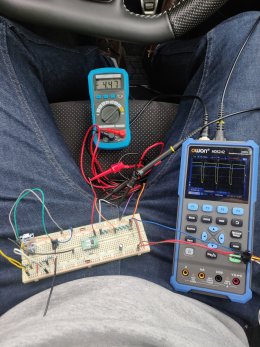

Hello again,
I did some more testing of the new smoothing circuit on the actual car this time. It works. :icon thumright:
I still didn't tap into the constant 12v, so for testing I am using the puddle light as a 12v power source, so the door needs to be open for it to work.
That's why in the video below you see the system turns on once the door is opened.
Already I can tell that the day mode brightness is too low but that's not an issue, as it can be adjusted any time in code.
I was worried that the smoothing will have to be done at a wider duty cycle range of the PWM signal, but it turned out that MIN value was about 65% and MAX is 100% so the range is quite small.
If MIN value was more like 20% then there would be issues, as the capacitor would not have enough ON time to charge up and output a smoothed signal with a load on it.
At the MIN value, the current driving the input side of the relay is 4.24mA at and 4.68mA at MAX. The relay turns on fully at 0.5mA and the max recommended current is 25mA, so that's all good too.
The smoothed waveform is actually identical to what i saw on the sim done on falstad linked above, so that's pretty cool.
The picture below shows the input and output signals on the actual car. The yellow is the original input, the blue is the smoothed output that's driving the relay.

Next I need to do something similar for the button illumination signal, as it is also a PWM signal, and I intend to use it to switch between day and night mode (button illumination ON = night mode).
However the smoothed output in this case can't be more than 5v while the input is 12V PWM, so I think a voltage divider or a clamping circuit of some sort after the smoothing circuit will do the job.

Some good news. I tapped into the constant 12v power source from the door control module, and the system works.
I tried to get the pin out of the connector so that i can do a proper heat-shrink job, but I couldn't get it out. I cut into the insulation, soldered some blue wire in and covered everything with insulating tape. Not the nicest but has to do. Blue wire is usually for the negative side and not a supply but its all I got at hand.

Here is a video of the prototype. I already ordered the PCB so its going to be real nice. The brightness adjustment is not shown on the video but it works, the light strip dims down when the lights are turned on.
Hi again,
Another small update, I received the PCB i ordered and they work fine which is great. A lot smaller than the prototype on the breadboard.
I will order another set though, as I should include a fuse on the board just in case.
I had it running in my room for like 72 hours non-stop as a test, and there were no issues.

So right now I have the wiring loom adapted in 2 out of the 4 doors in the car. This is done so that the trim piece with the PCB and the LED strip, can be just plugged in and it will work.
I also have the 4 trim pieces routed. A slot was cut away at the top of the trim, using the dremel tool routing table shown before, to make room for the LED strip.
That also worked out fine, although i had to do the final clean-up with some fine sand paper
I wrapped one of these trim pieces in brushed aluminium wrapping film as a test run, and it turned out good in my opinion.
Soon enough I will be glueing the LED strips onto the trim pieces and putting the car back together.
IMG 20230521 175401 IMG 20230521 175411 IMG 20230521 160713 IMG 20230521 160641 IMG 20230521 160636
BTW: if you have brushed aluminium trim in the doors and its scratched, doing this wrap is a good solution to remove the scratches i think! Its not expensive too.

Another small update, so far I managed to install it in the rear of the car and put the doors back together. I am really happy with the result.
In direct sunlight its not that visible but that was expected. When its a bit cloudy it starts to really pop
I did the initial test fitting with the door card off the car, so that I could push the trim pieces out from the back if something was wrong, instead of having to pry them out from the front and risk damage.
Here are a few pictures. Once I do the front, i will record a proper video to show the features and take some close-up shots.
