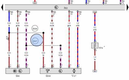

From what I've read on other posts the issue has been that the intake manifold has become worn and goes past the intended stops and therefore the ECU throws and error but my values has always been between 0 and 100%. I replaced the intake manifold and that didn't work, didn't change the values ("V Sw Vlv r Drft Opn mp" and "V Sw Vlv r Drft Clsd mp") either. I had a look at the wiring diagram in ELSA (attached) and from what I can see there should be ground at pin 4 and that was confirmed but I have about 4.3V on all other lines and that seems reasonable for G336 (potentiometer) but 4.3V seems way to low to actuate the motor that drives the flaps. I have no idea what voltages should be in this connector. When turning the ignition on there is no movement of the motor.
