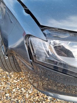

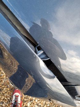

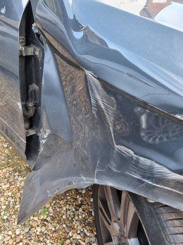

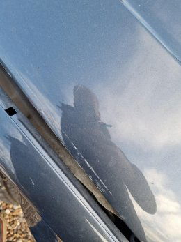

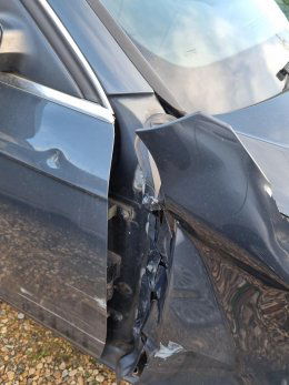

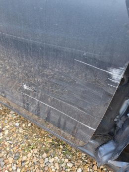

hi all,

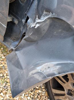

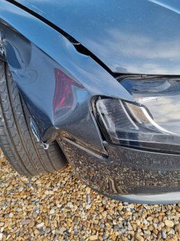

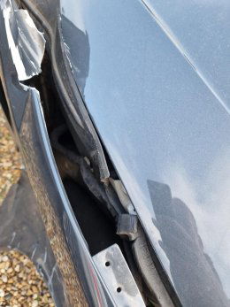

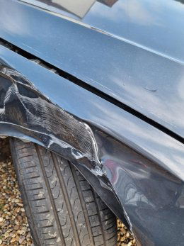

My first time on here. I have an Audi A4 avant quattro B8 and someone crashed into my car going ~20mph while my car was stationary. I did all the insurance admin but suddenly a company got in touch with my wife to pick it up tomorrow for salvage (with no consultation) due to it being a write off. Nobody asked for pictures and i would rather my car was saved rather than squashed or used for parts. Can anybody tell me whether the pictures attached indicate it is a write off? Thanks in advance. Tom

cost of repair versus the market value of the car, your ins company may have calculated it as not a viable repair, but thats not to say you cant buy it off them etc.

Looking at this, without really seeing the true extent of the damage (such as where the wing attaches) then you’ll need a door, wing, possible headlight bracket (if it’s loose) and some feathering on the bonnet. Getting parts in colour is the way to go too. There’s also the possibility of suspension damage, but you’ll need to take the front o/s wheel off to inspect. See what the insurance come back with, and there’s always the option you buy it back and repair yourself If you're spanner handy.
Yeap can see how they wrote that of, parts these days are sooo expensive & that is an expensive repair just on parts let alone paint & labour, it's as stated, cost of repair against market value, those pics backup there decision.
