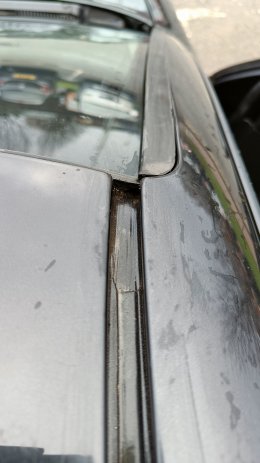

Change of subject, what path does the water from the roof channels follow? I'm assuming it passes right next to the windscreen edges as there is a gap ..
No its not glued.
Yes it goes behind the black plastic trim
Reactions: Stonedofmoo
As an update to this, I am 99% certain I have fixed it now. The drainage channel that runs down past the windscreen on the driver side was completely blocked at the bottom with silt build up. I only discovered this after removing the rubber trim that clips over that channel.
Clearing the channel out so water drained down correctly immediately improved the issue, but didn't completely fix it in heavy rain. The windscreen cannot be totally sealed on the bond. It's an original Audi screen but an old car and I'm sure the bond doesn't last forever, or it's been badly resealed in it's past. Because of this water is getting in past the screen and leaking somewhere down the A pillar/cover and running down to the noise insulation below, where is finds it's way to the footwell in time.
Anyhow after being quoted £145 to re-bond the screen, or £285 to replace the screen if my existing screen broke on removal, I decided I'd work around it by sealing that edge of the screen myself. I bought black silicone for car window work and simply squeezed an extra silicone seal into place putting a silicone wall in place between the screens edge, and the water channel, but leaving it clear to drain.
I'm not going to lie it was a messy job as there isn't a huge amount of access and it took me three sizeable beads of silicone to get the gap between the raised screen and the bodywork filled, but luckily I had a spatula that got the silicone in there nicely, and panel wipe cleared away any excess that was where it shouldn't be.
