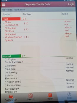

Hi Rob,
Thank you very much for your reply.
I had a friend help me to scan the car.
Here are the results. Do you see a specific one that is causing the the problem?
Thank you.
BR Mihir
20220804 20041120220804 20011920220804 20022120220804 20032120220804 200020
Well you have two possible sources, 09 and 46, not specific to your problem but may be connected as they are in central electrics and central module comfort.
You would be wise to rectify all those faults really if possible.
Clears the faults showing at the moment, run the car then rescan and see what pings up.
Hey Rob,
09 was just a brake light bulb. I replaced the bulb and it is fixed.
However, 49 remains even with rescan. But I am unable to find the source for it. Even the problem code #ff,00,00, 00 seems quite random and I am not able to find anything on this.
BR Mihir
